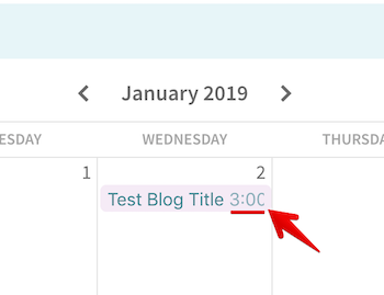

Hi, trying to resolve Calendar view issue: even the format for time in the list/column is MM/DD/YYY, in calendar view is showing with HOUR attached - see attached. No matter which column I choose or hide. Looks like this number 3:00AM is repeating in multiple calendars. - see attached.
Q: How to remove (hide with formula?) hour time?

@Ivan_Podnar I think your issue is a bit simpler than the one @Michael_McGreal linked to there actually.
I think yours is just a matter of time zone. Coda doesn’t currently support time zones really, and treats everything in Pacific time. It looks like you’re in Eastern time.
What’s happening is your column has dates, which Coda is interpreting as Pacific time dates. Then when it shows you the calendar, it knows you’re browsing as an eastern standard timer, and says “ok a date that starts midnight pacific should be shown to you as 3:00 AM”.
Workarounds:
- Add a column with formula
Date-hours(3)and calendar based on that instead. It should show your dates properly (but on the downside, you will lose drag-and-drop functionality), or… - Explicitly specify the time zone in your date column. I forget off hand how to do this but if you search the forum for time zone you should find something. May only apply to date+time columns not date only? not sure.
I think the Coda team has plans to add robust time zone support which would be super helpful for anything date/time/calendar based
