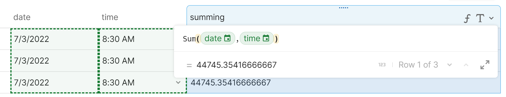

Hello Denis! I am struggling to make start and end datetime columns for a calendar view from separate date, start_time, end_time columns. Could you please share once again the fomulas you are using in your doc?
Hey there!
Dates (and times) are in the background are actually numbers in Coda.
Days are whole numbers, and times are fractions (12pm in a day would be = 0.5)
Therefore if you have date/time columns and want to combine them into date/time values for calendars, timelines, etc you can simply add them
Then just set that column type to date/time!
