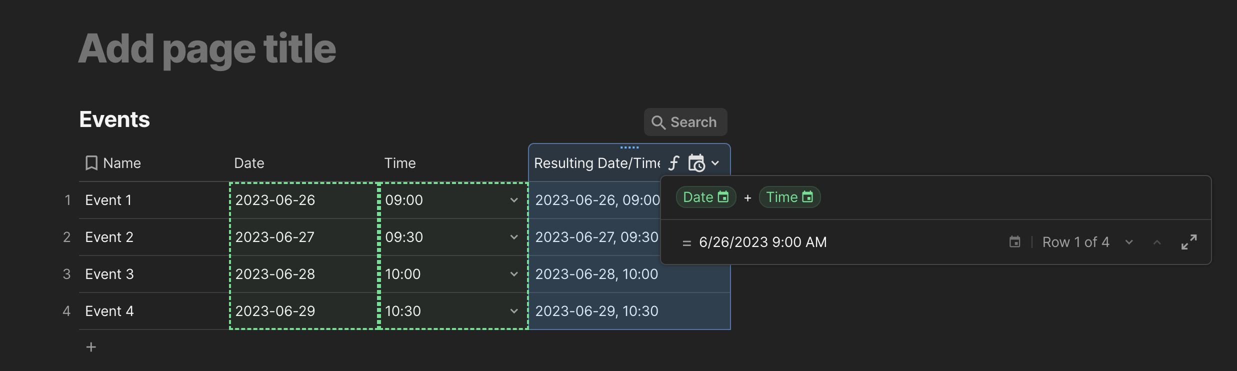

@Adam_Maggs: Depending on your actual setup, you might not necessarily need to go through this formula to create a Date/Time using a Date and a Time field.
Date, Time, Date/Time and Duration are just numbers under the hood :blush:
So, you can actually add a Time value to a Date one to create a Date/Time
(See the field [Resulting Date/Time] in the sample below)
Oh wow! Thank you, that’s so much easier! I was trying concatenate and other options - hadn’t realised. Super appreciated @Pch
My pleasure @Adam_Maggs :grin: !
