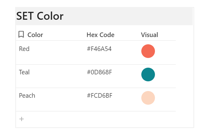

I have a Table with my Color Scheme
Diferent tables have a LookUp Column to this “Color Table”, and I can dhoose a Color.
What I would like:
When choosing the color, the row should change to this color.
Is there a way to do this?
It would be more easy, if there were a column type “color picker”.
Hey @Kristijan_Moser,
it is not possible to change the color of the row from a predefined hex value.
In theory you can change the color of a row with conditional formatting option, but it is not practicle for your use case, as you can only choose by a range of the predefined colors, not a variable one, and you’d have to set it up for each color on their own.
The only way/formula of using a custom color code automatically right now is in the reactangle shape, but I guess that’s what you already did in the “Visual” column with a circle clipper - which looks cool btw

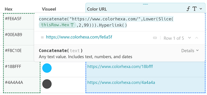

@Kristijan_Moser,
as @Daniel_Stieber indicated, this is it for the moment. Since I need color logique quite a bit I added something that might help you as well to make the best of it:
and the logic I apply is:
concatenate("https://www.colorhexa.com/",Lower(Slice(thisRow.Hex,2,99))).Hyperlink()
As such I always have a direct link to more information about the color.
