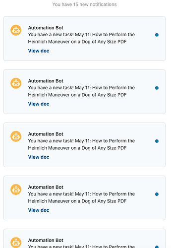

Thank you! I was able to get it to work. But now I’m getting 15 (!!!) notifications every time the rule runs. Why is that??
The “Recipients” field is cut off in the screenshot, but the full thing says “LinkedIn Content Queue > Assigned To”
And in the activity tab, the notification only shows that it’s running once. But it shows up in my Slack Coda app 15 times.
It is hard to diagnose without looking at your document, but my guess is there are 15 rows in the linked in table. So every email address in that table (column) gets your message. Recipients should be something like step 1 result.recipient, or, if you are getting the recipient from another source, you should limit the number of recipients with something like .unique().

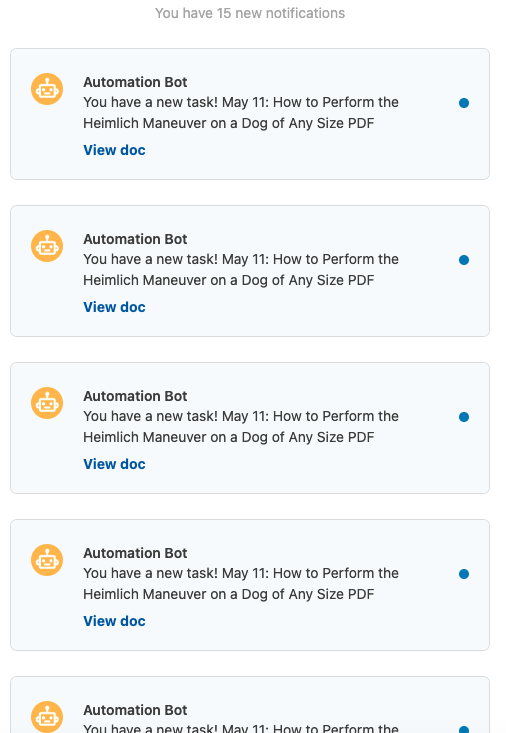

I’m actually getting the notifications 15 times for each row. For example, each of these notifications are all for the exact same row:
Like Joost mentioned, it’s because youre feeding the entire table into the recipients field :sweat_smile:
Try changing it to step 1 result.assigned to
