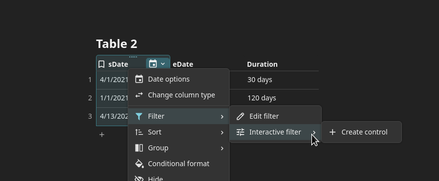

I may be misunderstanding, but I think this is possible:
You have to first put it into a list by the looks of things.
Amazing @Connor_McCormick :trophy: :trophy: :trophy:
This is exactly it! Thank you very much @Connor_McCormick, you’re a life saver!
