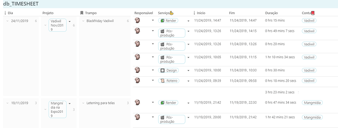

@Asaf_Dafna, In my case, things that is interesting to have more control on each entrancei like of take this “each row is a entrance” approach.
Like in this table:
But for making a work shift doc, were i wish to use a use each to store one shift , this give the flexibility that I need for making multiple breaks in the same shift without need to restrict how many breaks they will have :grin:
In the other centenary I was forced to use the extra shift if some employ really need one more break than I predict, what just f* the things. You can do more than one extra shift by day, but they also COST MORE.
Plus, if you set a big break limit, like “5 breaks per shift”, you making a incentive to they pick up all the breaks each day, ween i want to stimulate focus and give they freedom to make they breaks ween they need.
Now this is solved :partying_face:
So is not really about of advantages, but more about flexibility an more design choices.
Is one more tool in or coda-belt :bat:
You need to see what of they works best on your project.
