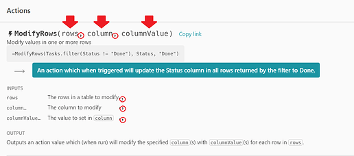

I have found it helpful in Coda when I see any formula such as ModifyRows()
to …
https://coda.io/formulas#ModifyRows
… study inside the parentheses [ ( ) ] and around the commas [ , ]
