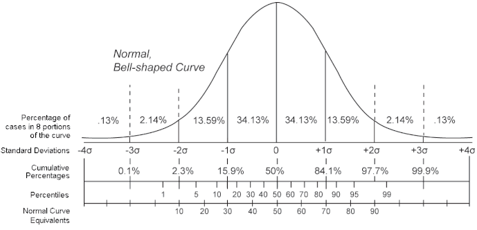

I believe you want something like mean - stddev, mean - 2*stddev etc, as in Bell curve?
