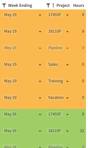

It looks like you need to separate out the payments into another table: contact details in one table, payments in another. Each month should be stored as a separate row in the table, not column, with a date field and the payment details. Then you can report on the payment table with a lookup to the contact table and group by the date along the top to get the result you want.
Similar to this…
There’s a table of hours worked by a particular engineer (column hidden) on a particular project in a particular week by week-ending date…

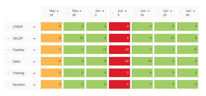

…and this is then reported horizontally like this:
This way all the variable data in your model is stored in rows, not “hard-coded” in the schema (columns) which means you never need to alter the structure of your application as time goes by.
