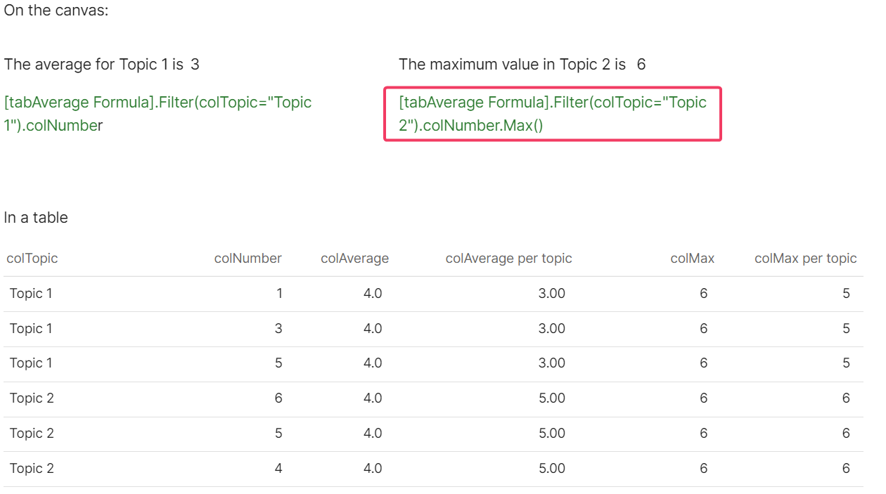

On the page Mathematics Formulas in Tables you will find a model. (Just replace .Max() in the formula with .sum().

Hi ,
If you click on the doc above, it should open on the page “Mathematics formulas in tables”, as per the below screenshot:
This is to do the formula on the canvas.
And the screen shot below is to do the formula in the table itself.

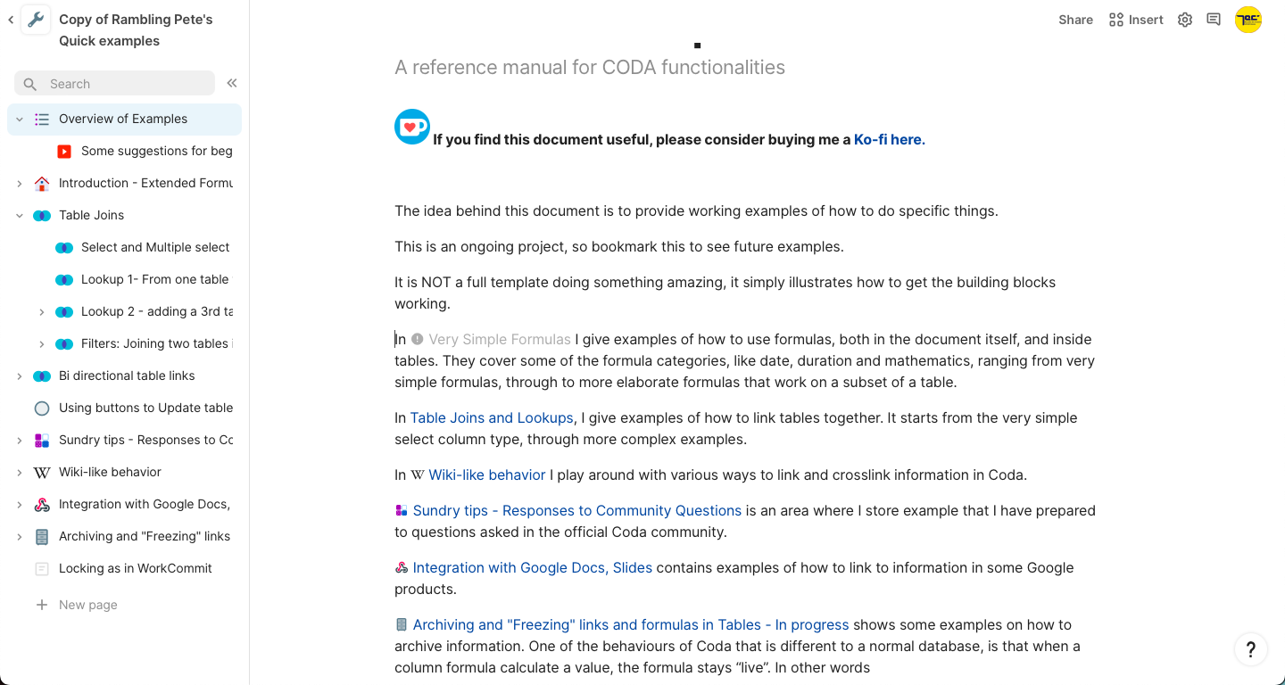

Hi,
In the top left of your screenshot, there is a search box. Use that to find the page.
