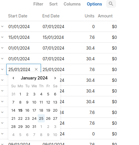

Hi. I’m in Australia (yes, it exists) and the document locale is set to my timezone.
I have added 2 date columns for start and end with format dd/mm/yyyy. The columns appear to be recognised as date types. The values are data (not a formula).
Screenshot from 2024-01-15 18-13-59
Screenshot from 2024-01-15 18-14-09
Configuring the timeline range however does not work. Can anyone please suggest how to resolve this issue?

Hey @Nicholas_Keown! For Coda column types, we don’t overwrite the data that you enter when you choose to show a date or a date and time a certain way. We only display it in that format. It’s possible that your dates are actually entered in different formats as underlying values (e.g. some might be 12-10-23 vs some might be 12/10/23, etc). You can see this if you change the column type to “Text”.
If that’s the case, a workaround is to create a new column and add a formula to force those values to be shown as consistent dates:
[Column Name].ToDate()
Then, spot check to make sure that the original dates and the new column dates look the same. Then just copy/paste from that new column over to your original column.
That should use the correct values and all the same date type, which should get you sorted!
