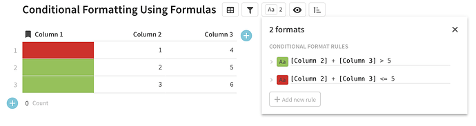

Great questions!
For the first one, this is a way to conditionally format a cell using a formula that references the values in other cells:
Is that what you’re looking for?
