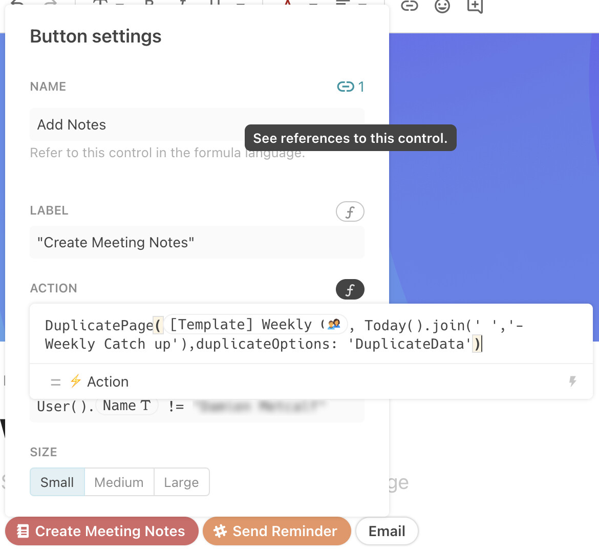

I currently have a button set up with the following action:
DuplicatePage([\[Template\] Weekly Catch up], Today().join(' ','- Weekly Catch up'),duplicateOptions: 'DuplicateData')

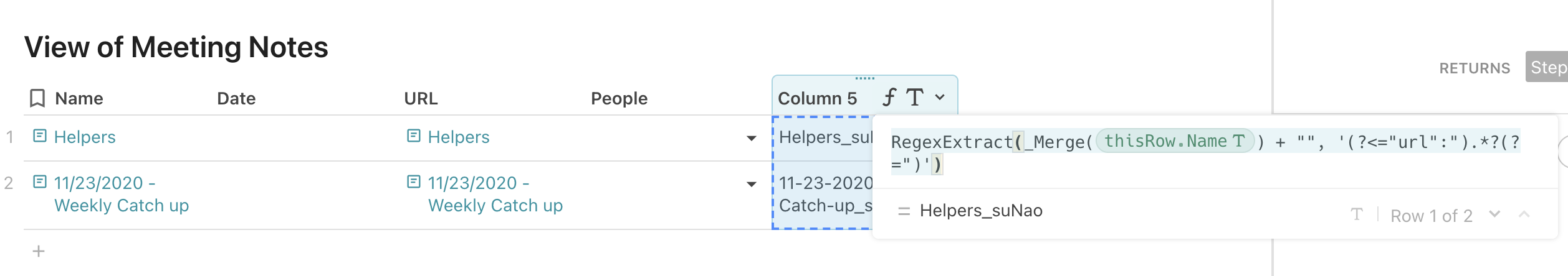

This adds the url but doesn’t seem to link it. I also then have a formula on column 5 that takes the URL and extracts the Section ID, RegexExtract(_Merge(thisRow.Name) + "", '(?<="url":").*?(?=")') This works if I manually add the url to the name section using @section-name but it doesn’t work when adding the url via the automation.
Meeting Notes Table:

Button Setup
Any ideas on what might be happening, I’m thinking I’m formatting the url incorrectly but nothing I’m trying seems to work.
