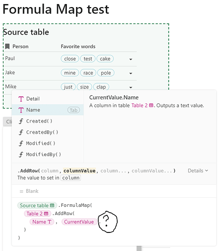

@Jason_Tamulonis It still doesn’t resolve CurrentValue in .FormulaMap(AddRow()) context properly.
E.g. here the suggestions should be from Source table, not from Table 2
Proof that CurrentValue in this context is actually a row from Source table is that this works:
Hi @Paul_Danyliuk,
Sorry about the delay. I didn’t want to respond until I had an answer I was happy with :slight_smile:
The problem that you called out is a pervasive issue we have had with how we handle context with loops, which is a slightly different beast that the original update. I was able to take some time over the holiday break and fix it though. If you reload your doc you should see this is working now.
I will point out (before anyone asks) this doesn’t add support nested loops, which we would like to do at some point. It should improve several scenarios similar to the one you listed above.
