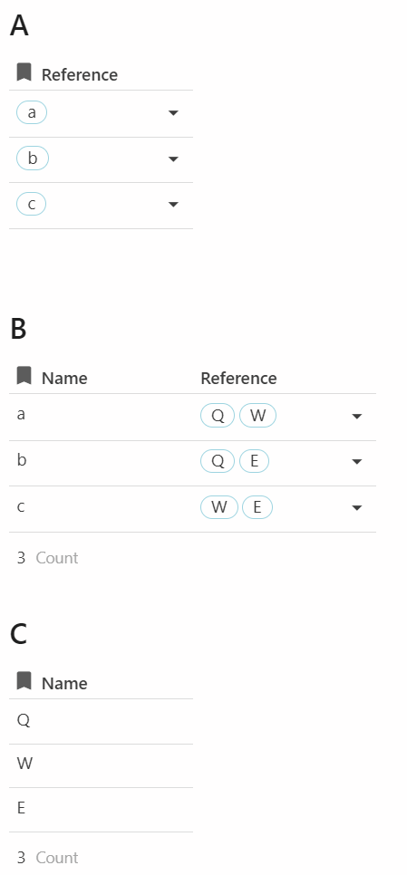

Reproduction Steps
  • Create 3 tables, each with a Name, and Reference value that references the next Table, like so:
  • Create a named formula “Test 1” that outputs a List of Lists, e.g.: A.Reference.Reference
  • Observe that the description of this formula is: “A formula. Outputs a list of lists of unknown values”.
  • Observe that you cannot use any autocompletion on the values inside this list.
  • Observe that if you copy-paste formula “A” inside the new formula, create a correct formula using it, and then replace the copy-pasted part by “A”, or A.Value, the formula is still incorrect. E.g.:
    • Does not work: “[Test 1].FormulaMap(CurrentValue.Filter(CurrentValue.Name =“Q”))”.
    • Does work: “A.Reference.Reference.FormulaMap(CurrentValue.Filter(CurrentValue.Name =“Q”))”
