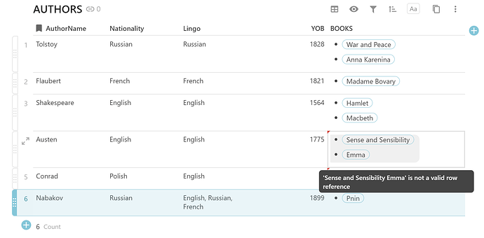

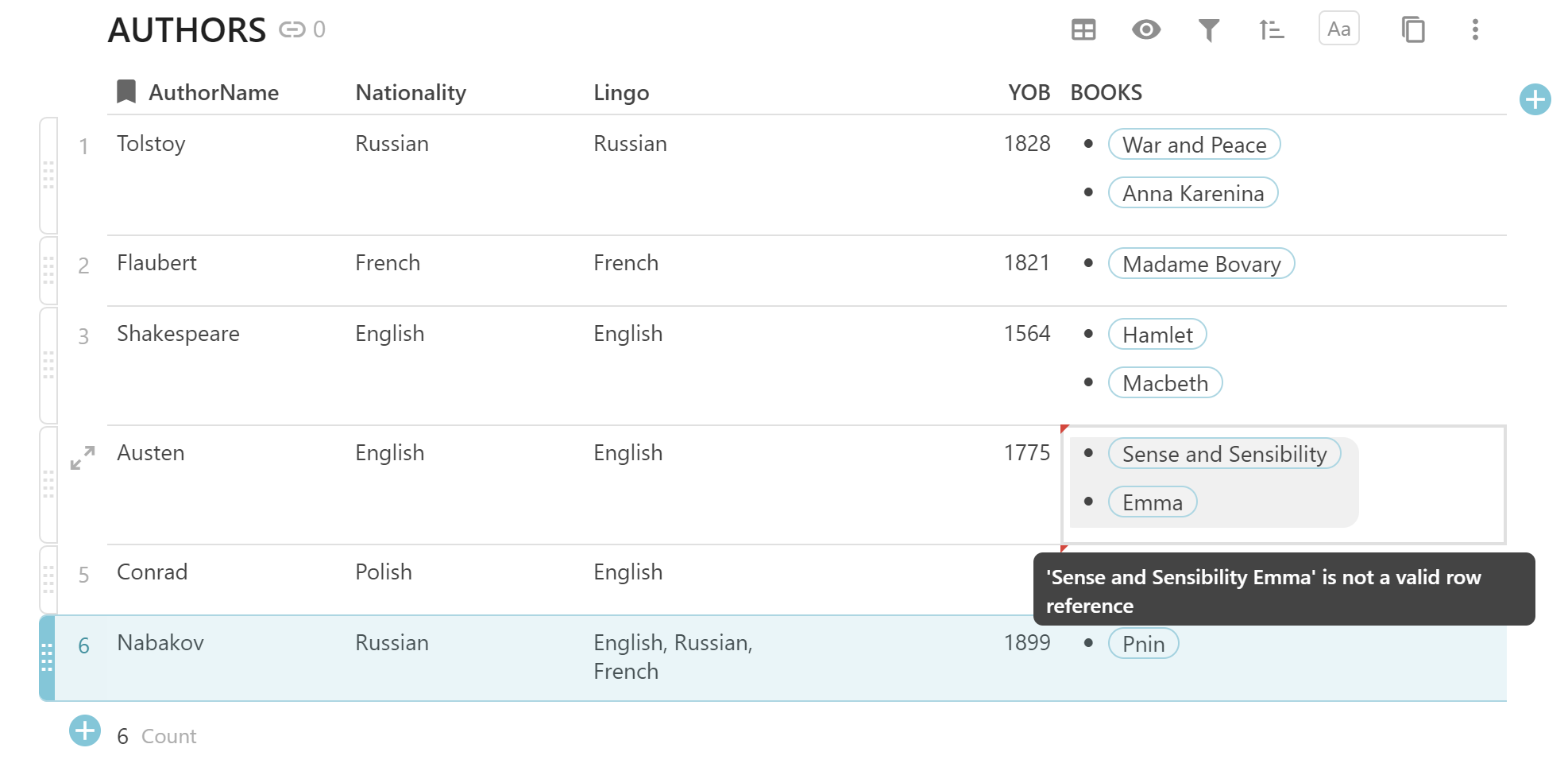

I’ve built a little test with two tables, AUTHORS and BOOKS. Here’s a screen capture of the AUTHORS table as of this moment:
The BOOKS column displays the names of books over in the linked (related) BOOKS table. As you can see, there is no error in the BOOKS column for rows 1, 2 and 3; but rows 4, 5 and 6 are flagged with an error identified as “not a valid row reference”.

And got the result shown, with errors in rows 4, 5 and 6. Questions.
  1. Why did I get these errors?
  2. Why didn’t I get the same error in rows 1, 2 and 3? After all, the formula is attached to the column, not to specific rows.

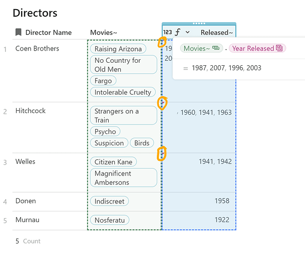

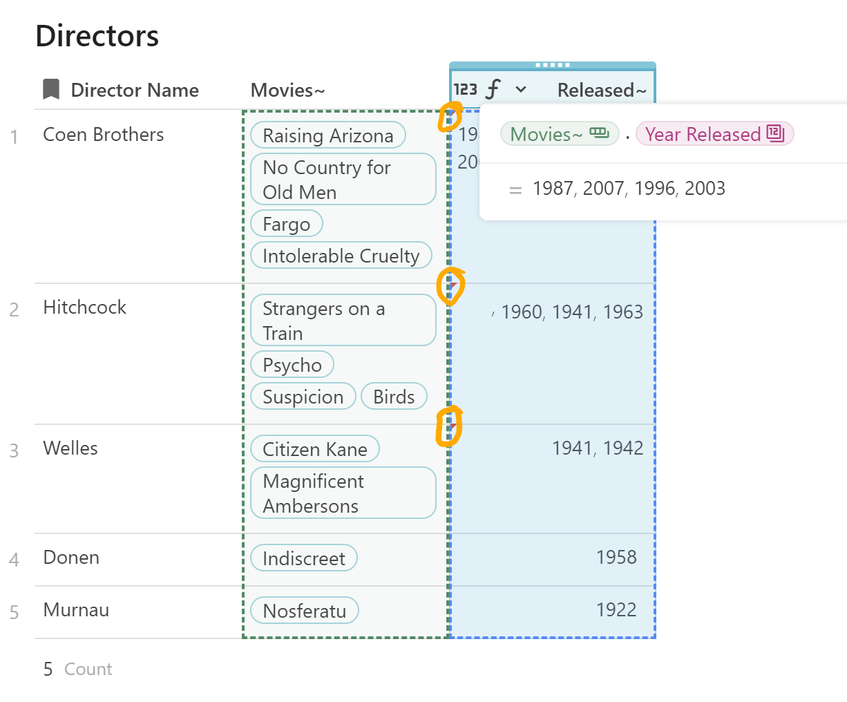

I might add that some of my problem is that the explanation of the error (“invalid row reference”) is not very helpful to me, and I can’t find a more detailed explanation. By way of contrast, here is another error that I ran into today, where the error notice instantly made sense. Here’s a picture of my screen while the error was still visible:
Note that rows 1, 2 and 3 are showing the little red error flag. (I’ve circled it to direct your attention to it.) But when I added Stanley Donen’s Indiscreet (and only that for him) I noticed it had no error. So I added Murnau’s Nosferatu as well. Obviously, both those directors are linked to only one movie, while the directors in whose rows the error flag is shown, are linked to more than one movie each.
When I hovered over the “Released~” column, I got the error message: “Cannot convert value to the specified format.” And that made perfect and immediate sense: The column “Year Released” over in the Movies table is a 123 Number field. But this list of release dates in this column in Directors is obviously a string. I just changed the column format to Text and the errors went away.
