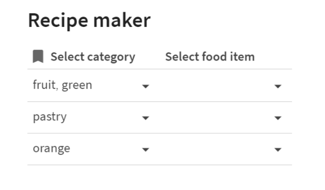

Basic stuff right? Next step: a ‘recipe maker’, i.e. narrowing down possible food items by the selected category or categories. Like this:
UPDATE for clarity: selecting “fruit” as category should provide select list “apple” and “orange” (in ‘select food item’), selecting “pastry” should provide select list “donut”, etc.
I’ve been fiddling around to make the second column work, but no luck so far. I’d really appreciate any help/suggestions, if this is possible at all of course (is it?).

  1. To start off with, I’d happy if ‘select category’ would only allow 1 entry (per row).
  2. If it allows multiple entries, however, it would be preferable if this narrows done possible food items rather than expanding them: an ‘AND-filter’ rather than an ‘OR-filter’.

Here’s my report: it works great :grin: (at least when selecting just 1 category). The solution seems so simple, but I’d never have come up with it!
Currently, selecting more than 1 category leads to a bigger selection. E.g. selecting “fruit” & “green” leads to a list with all fruit items AND all green items, rather than everything that is fruit AND green. This is easy to fix if the number of selected categories is fixed (e.g. 2):
Filter([Food item DB],[Select category].Nth(1).In(Categories) AND [Select category].Nth(2).In(Categories))
This, of course, breaks when the number of selected categories is greater or lesser than 2. I’m struggling to find a way that works regardless of this. I figured FormulaMap() might be of use here, with Sequence(1,[Select category].Count()) as a way to iterate through every index of the list. But this might be a bridge too far. Thoughts?
