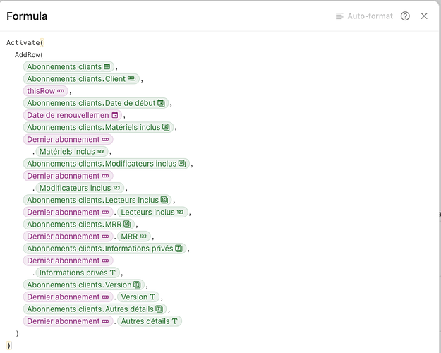

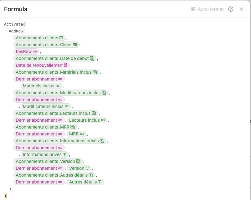

Hello @Agile_Dynamics,
I just checked and everything is working fine since I removed the “Activate” feature.
Here is the formula that works
Here is the formula that generates the error
The button I created is a button to be used manually. In 2% of cases, I would like the BOT to do it.
So I added the “Activate” function to display the row created in modal.
Either I do 100% by hand but it’s not cool :slight_smile:
Either I remove the “Activate” function which prevents the automation rule from working.
It’s a shame as a choice.
What would be good is that this UI function does not activate on the server side (it seems obvious) but above all leaves the rest of the function executed.
