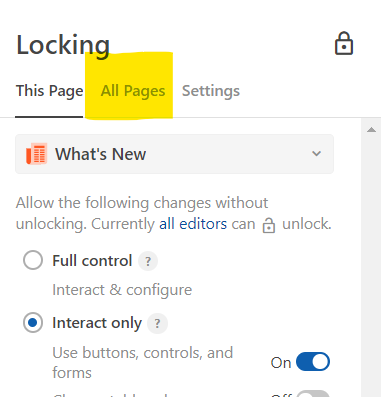

At least the page with the buttons should have the below setting, and you should be good to go:

Nope, did not work. The setting was already on full control. And still no one outside my organisation can use the button. :frowning:
Dear @Cornelia_Gamst,
If all pages should be interactive, you can make the settings in one run at the “All pages”
