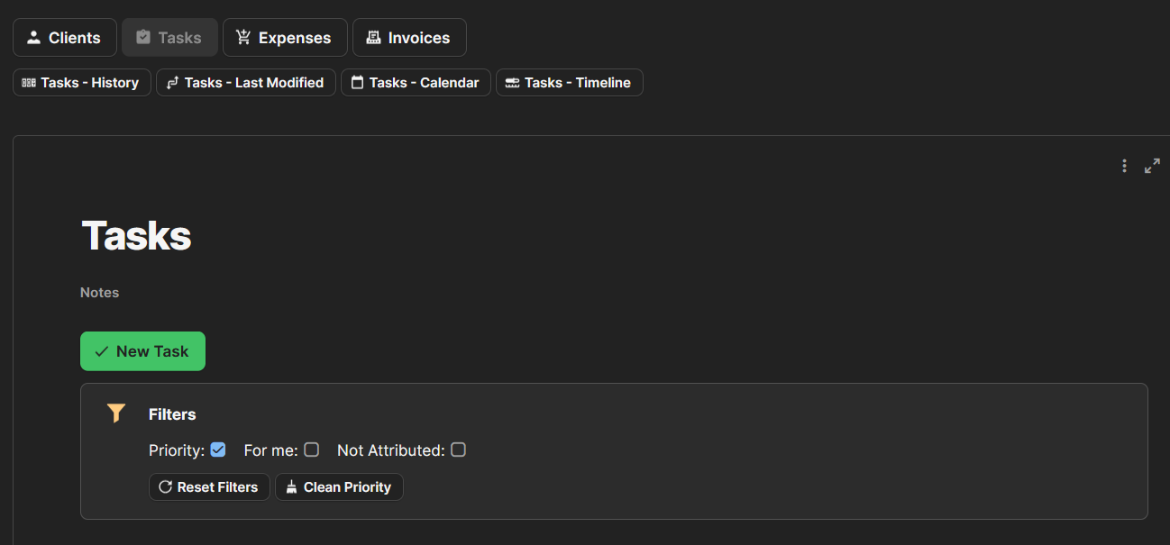

Hello, I suggest you use a toggle control.
Then add a filter to the table based off the toggle’s value.
If you want to use a button, you can set the button’s action to set the toggle’s value.
Let me know if this helps!
I think it’s “hard” because a button only have one function, so if you apply a filter there’s no way to remove it unless you create the opposing button.
Instead you have to use canvas control, and you can alternatively make a button to change it’s value.
If you want to apply several filters, you can use a slider with the specific amount of numbers, and then a button to change the value.
So the table filter connects to the slider, and the button also connects to the slider.

Works for sliders too, I have a table with 8 different filters being applied by a slider, and 8 buttons to change the values of the slider.
I’ve hidden the slider in another page since I don’t need to see it.
Do you mean (for example) you have buttons like 0-25%, 26-50%, 51-75%, 76-100% that are set to particular amounts on a slider?

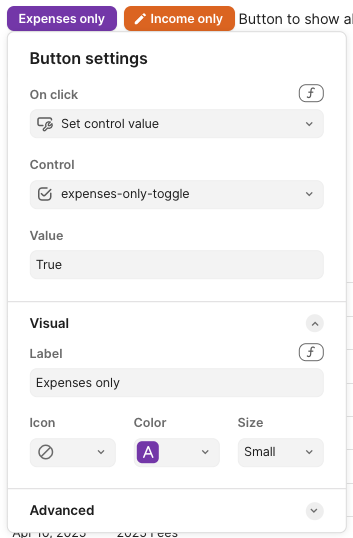

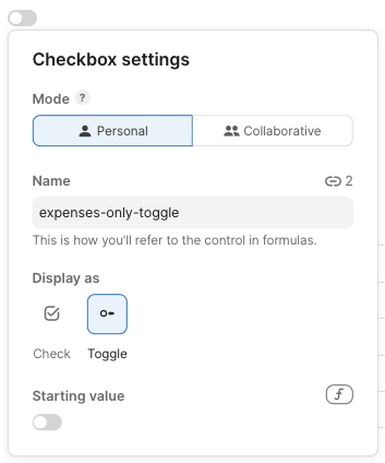

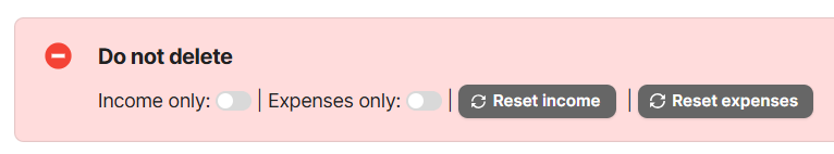

I created this section below my table.
  1. Income toggle
  2. Expenses toggle
  3. Button to reset income toggle
  4. Button to reset expenses toggle

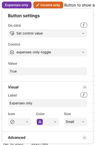

Then above my table I have three buttons.

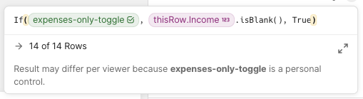

  • Pressing the Income only button creates a filter where the field Expenses is blank and it shows only my income records.
  • Pressing the Expenses only button creates a filter where the field Income is blank and it shows only my expenses records.
  • Pressing the Reset button pushes two buttons 3. Button to reset income toggle and 4. Button to reset expenses toggle. This removes one or both filters from the table.
