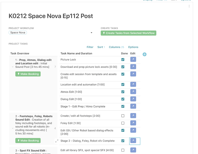

Bit of a riddle this one. I’ll try log back in later tonight to make a dummy doc to show, but its quite simple to explain.
Create a table with buttons in a column.
Create a column which you group together.
Group the column with the buttons as well.
This will show a single button in the group, and it works well. Indeed, I’ve designed an entire workflow around it (the one button presses a number of buttons)
So in this case, its the make booking button. However, it can be any button.
However, when you publish the doc, the button becomes disabled.
And there is no formula to disable the button at all.
I’ve tried this quickly on a few different tables, and they all show this behaviour. Its a major issue - an entire system for us at work has been designed around this grouping - and now I’ve transferred everyone over to a published doc (the staff LOVE the drop-down menus) they can no longer use this part of the app.

So I now think this might be a bug - but would be awesome if others could confirm / figure out a way around it.
Here’s a test
Then when you publish, the grouped button stops working

Thanks - can anyone think of an alternative setup to what is in the first post?
The button assigns all the tasks in the stage to a new booking.
Doing it the way I have set it up allows someone to both see what has been done (all tasks) and easily assign a whole stage (group of tasks) to a booking. Since many of the tasks are short, we don’t want to make tonnes of bookings (which would happen if you made one booking per task!)
I could make a second table which just shows the stage (so has just one button) and does it without grouping, but then there’s no way to display the tasks - and it would involve a tonne of scrolling to see what’s done / what’s not on a second table.
