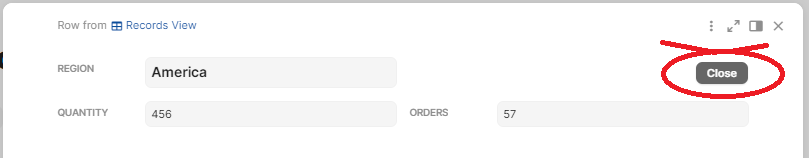

Users find it much easier to close dialog modals when there is a obvious button for them to click (the default X symbol is tiny and hard to find)
Add a button-column to your tables and configure it in the Layout-Editor as follows…
  1. Position the button top-right
  2. the action formula is OpenWindow(ObjectLink(tableView))
  3. set the LABEL-STYLE to ‘None’
  4. set theAlignment to right-justified
When the user clicks on this Close button, the dialog will be closed and they will be returned to the Page that contains the tableView you specified.

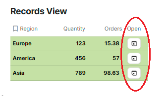

I also add a button to OPEN the dialog (as mst workflow pages are LOCKED) so the user can pop-up the dialog to edit the row by clicking on the symbol shown below…

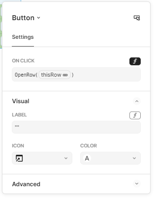

The configuration for that button is as follows…
