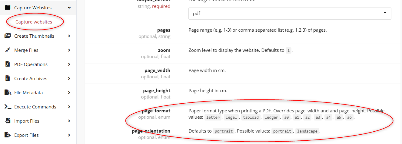

On the CloudConvert website the API documentation gives you some info too:
page_styles you have to figure out yourself by trial and error and see what is supported. For me, it was good enough to be able to define Arial as a font family, but you can set color as well (limited to one setting for all of the output). It is plain vanilla html/css.
When editing the code, you have to set the option name and the parameters. The option names get listed at the bottom (after a while - let the cursor just sit as shown in the red ellips). Some of the options give a hint of the possible settings, but it is not very clear. The ones that I figured out are selectable in the options lists I provided in the template.
