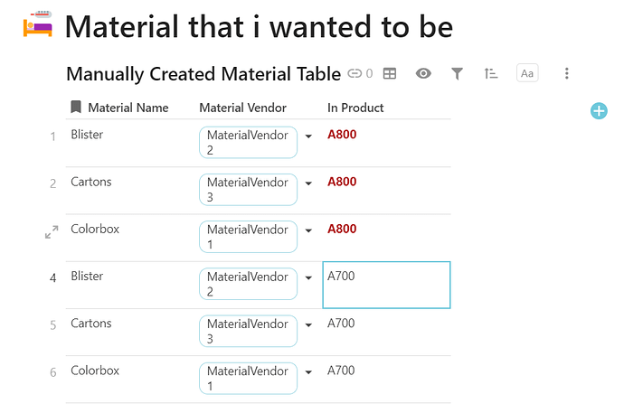

as you can see in Materials table the Product Name showing the results of two product sepreated by comma , where as i wanted to display each row with each product instead of merging them , so that i can make the Material Order Date properly , right now if i assign a date to Product A800 for material Blister it will get assigned to A700,A800 both which i dont want. Is it possible in Coda ?
I want to display something similar to below , can someone help me give any suggestion or guide .

Its been a while , as i was travelling and not able to work on my coda project . Here i have created the manually Materials table to elaborate more , i am sorry for my english as english is not my native language.

I think my explanation was not good enough I want to display each material related to that product in each row instead of combined in one row instead as shown above in the first few posts

Thats great, its looks good. But again i am facing the same problem as previous , if you check the Material Table the product A800 and A900 both is showing together , where as i want to display separately , the reason of doing that because i want to track of each material of that particular product , like which date it was order , is it pending or done already , why it is pending etc , but if merge two product i wont be able to achieve that.I have also update the materials table to give me more practical look it might help me to explain my idea.
