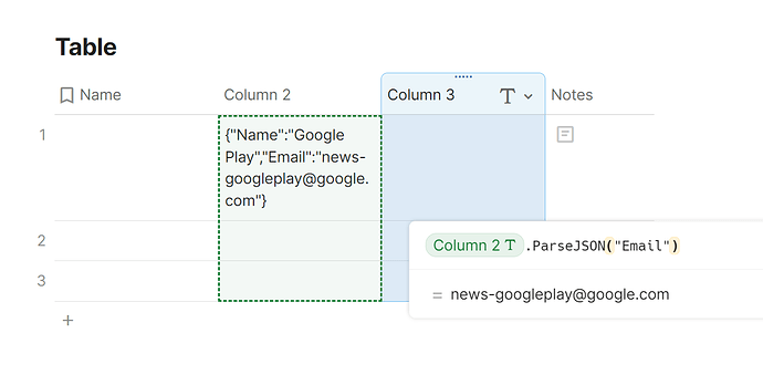

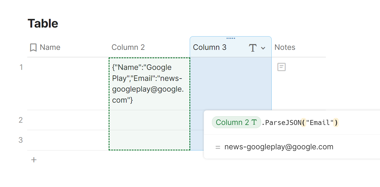

For anyone looking in future, I implemented Christiaan’s suggestion but you have to reference the pack directly and not the From column in the pack table, even if it is the same thing.
This works: image
This does not: image
Even though the column is:
