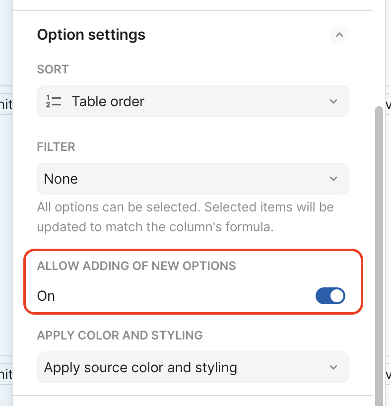

With a recent update, the “Add new” row at the bottom of a sub-table in the modal is grayed out for many of my functions. I gather this is due to how I have formulas filtering the available info on the row, but it used to work. So now the only way I can see to add rows is either select a current row and hit “Enter” to create a new row below, or code in a button.

I was messing around trying to find a work-around and I believe I may have a solution. The sub-tables that were graying out the “Add new” row were based on columns that I had created sub-table relations to through formulas, before the creation of the Linked Relation columns. When I changed the column type to a Linked Relation, the “Add new” now works as intended.

Thanks @Ben_Peine, this works for me as well.
