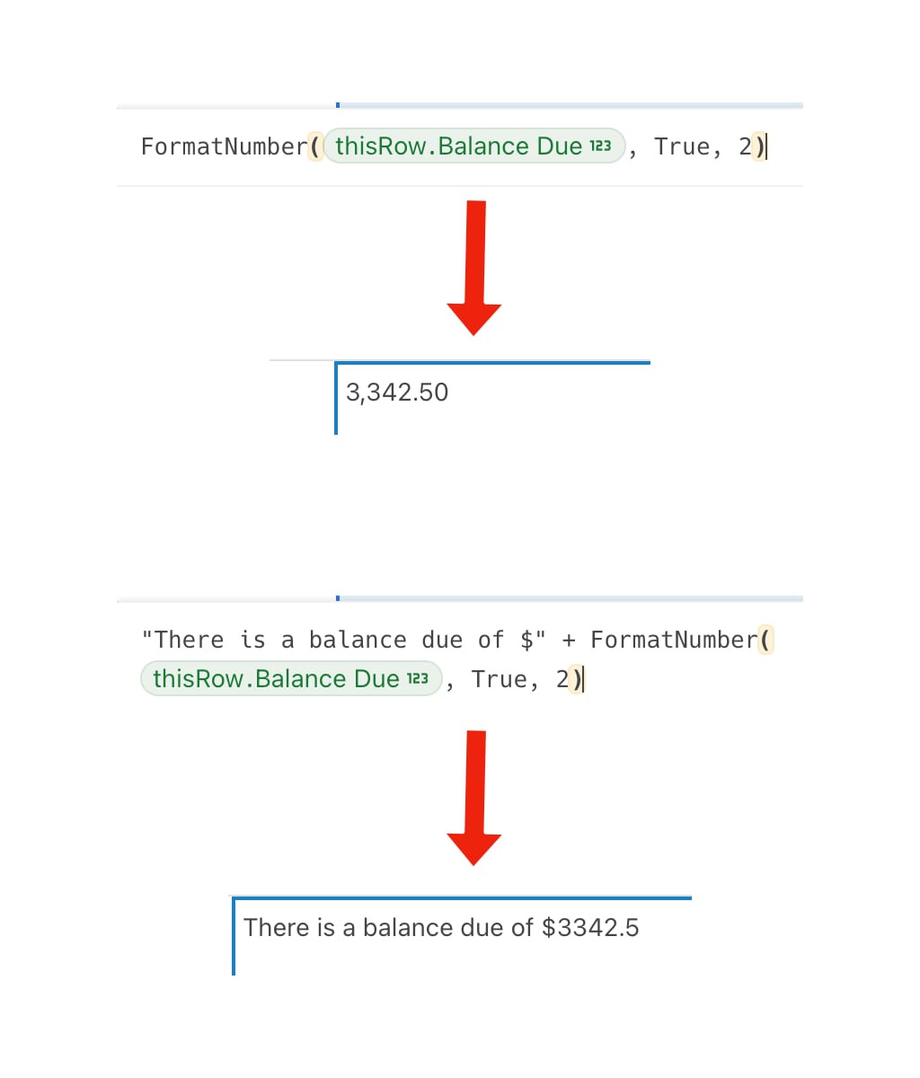

I know this is an experimental function, but I’m having a lot of trouble getting currencies to display correctly - $12,345.56.
FormatCurrency seems to work differently depending on whether or not it’s combined with other functions.
See screenshot for an example. (The $ symbol is shown in the 2nd example because I added it manually.)
Any suggestions on how I can display currency consistently?
Hi @Graydon_Trusler,
I guess the issue is not in the formula itself, rather in using the plus sign (+) to concatenate strings: discouraged as this is not how Coda implements String concatenation.
In order to do this, you can either use the Concatenate() formula:
Concatenate("There is a balance due of $", FormatNumber(thisRow.[Balance Due], true, 2))
or - preferred, but it’s my personal choice - Format()
Format("There is a balance due of ${1}",
I hope this helps.
Cheers!
Thanks @Federico.Stefanato - that worked perfectly!
