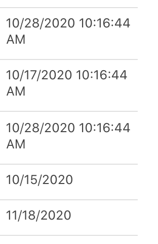

My Gantt Chart thinks that the items I’ve ordered will arrive in the year 2140.
But my order date and estimated arrival date for that product clearly end in the 2020s.
My chart display setup looks like this:
This might have to do with how the date was entered. That’s at least something to double check first, then we can at least rule that out.
You can create a column next to one of those and use [Start Date].ToText() to see if the date is written different.
You can write into Coda Support as well so we can take a peak there and see if something else is going on.
Looks fine. Does have mixed types (Datetime and Date) but I wouldn’t expect that to cause issues
[Estimated Arrival].ToText()

No that wasn’t the issue.
The solution was to use .ToDate()or ToDatetime() at the end to fix the error.
Occasionally, formulas get confused and return content as the wrong type. Specifying it explicitly solves this problem.
