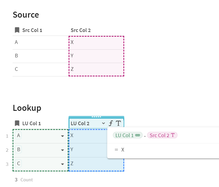

Like this?
The “Source” table is where your source data is stored. The “Lookup” table is where you enter your input and see the output magically appear. Simply enter a value into “LU Col 1” and see the result appear in “LU Col 2”.
The “magic” is in the formula in “LU Col 2”.
Here’s a more elegant way to do it with a lookup.
In this case the value in “LU Col 1” is actually a reference to a row in “Source” which means you can simply “indirect” right through it with dot notation.

Dear @Jochen_Zeller
When you open the doc and create a copy by pushing the button. In this doc you will be able to see the formula(s)
Oh, i didn´t realize that this is a embed
Thanks, now it works.

You can type a formula anywhere.
Check out the bottom…
Then go to the source table, change “X” to something else and see it magically update not only in the lookup table but in the text below.
