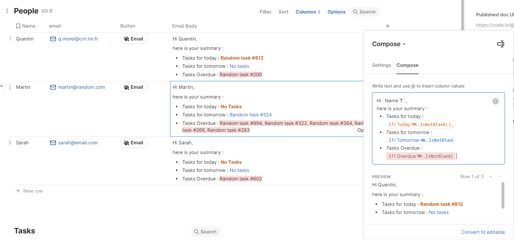

@Quentin_Morel Hello, any idea please about some easy formula how to send notify e-mail at 7am with tasks and its dates, that are due today, tomorrow and that are past due? Thank you!
Ahah @Marty_Nator this is a full mini-project that you are asking for. But as I’m in a good mood, here you go step by step !
This is a very simple example, but whit that you should be able to personnalize it as you desire !
  • Consider a People table, with email (eventually coda account) and a Tasks table, with a due date and a status
  • You can get a list of overdue, today and tomorrow’s task with 3 new column in People and formula like that, filtering people and dates
  • Then you can digest an email body to be sent with Compose function, using the 3 previous columns, something like that :slight_smile:
  • use a pack like gmail and a button to send email to current email adress, and with email body as content
  • Final step : set an automation that will fire every day at 7AM and click all buttons from People table
