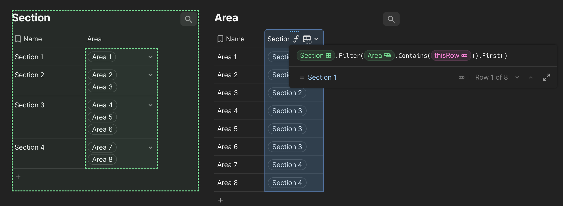

If so, you should add the “reverse” part of the lookup field Area in your Section table by adding a lookup field from your Section table to your Area table and using a formula such as :
Section.Filter(Area.Contains(thisRow)).First()
(Area in the formula is in fact CurrentValue.Area)
This will retrieve the sections you linked to the areas in your Section table :blush:

Could you try a slightly different Filter() formula in the Section lookup in your table Area and see if this help with the no matches found (for the performance section) in your [All Data] table :innocent:
SECTION.Filter(AREA.Contains(thisRow))
