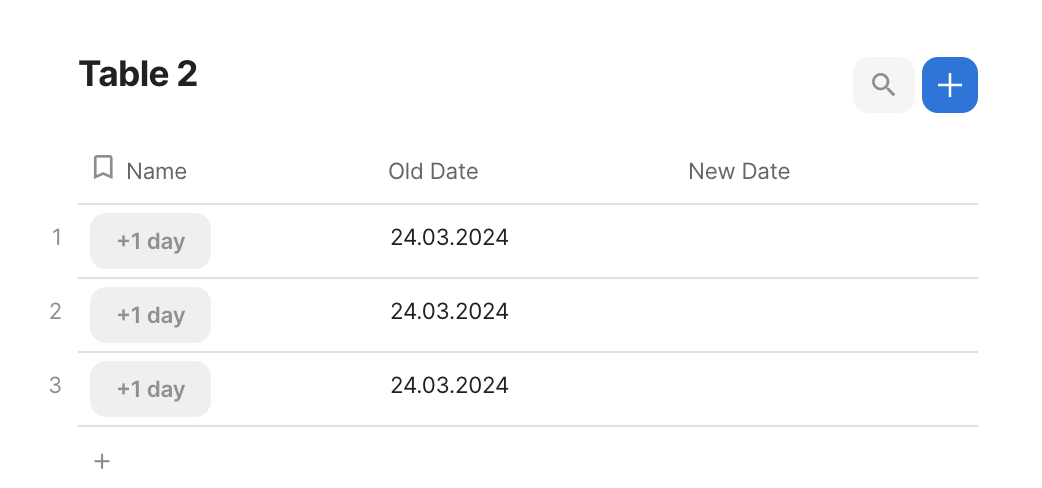

i want to have a button (in each table row), that pushes a task to the next day, so i can filter it out and it’s not blocking my todo list for the day.

@joost_mineur Great! The table is very simple yet:

but you need to add a sample doc, not only a screenshot
@joost_mineur had to create a new account. Here’s the table: https://coda.io/d/_dxVAGiRzX5w/Untitled-page_suLeo
Your column “Old Date” had a function, blocking the button to change it. I removed the function and now the button works as expected, increasing the date by one day.
