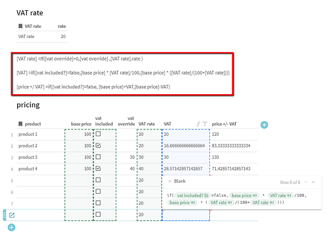

@Juanmata
I didn’t completely understand your post, probably because I don’t deal with VAT. But I tried to infer what you were after. Is it something like this?

Thank you, that worked however you have given me an idea with your layout that wasn’t possible with Airtable but now looks possible with Coda.

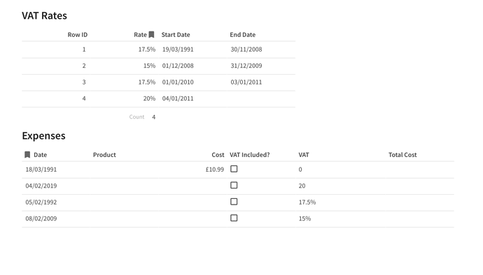

Here is my table, https://coda.io/d/Untitled_domfr8Pz5pX/_sueOx hopefully you can view it otherwise here is a screenshot just incase. I have left the VAT Rate table there so the actual table still works.

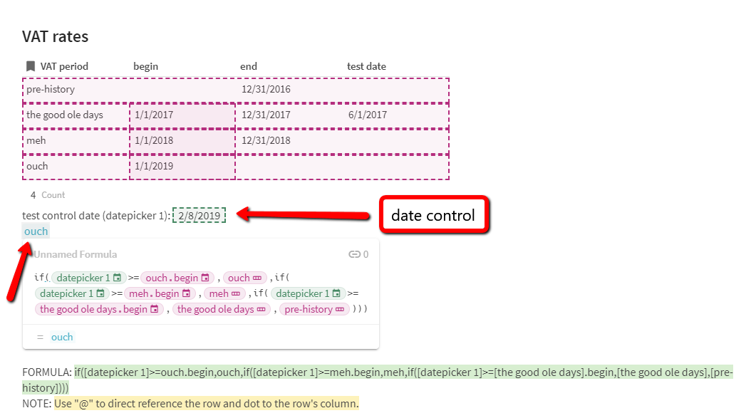

  3. Multiple VAT Periods. I built a test area to illustrate the building blocks that I would use.

OK, so a little playing around, I have the following formula.
IF(
	Date < date(1991,03,19),
		0,
		IF(
			Date >= date(2011,01,04),
				20,
				Lookup(
					[VAT Rates],
						sequence(
							[Start Date],
							[End Date]
				Date
So, any date before 1991,03,19 gets a rate of 0%. Any date after 2011,01,04 gets a rate of 20%. Any date inbetween gets the date from the VAT Rates table.
Now although this does work, I’m manually putting the VAT Rate after 2011,01,04 in the formula, same again for the beginning date. I’m also getting an error saying that Sequence is the wrong argument type.
