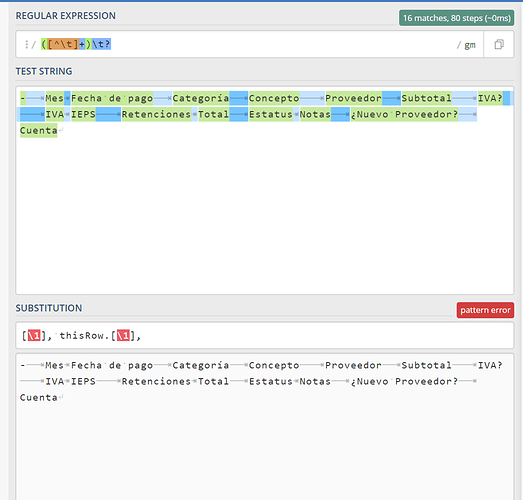

  1. Copy the table to a text editor or right into an offline / online editor that supports regular expressions (I prefer regex101.com, not affiliated). Remove everything but the headers
  2. Set up replacement with regular expressions:
    Search: ([^\t]+)\t?
    (means capture each element between tabs)
    Replacement: [\1], thisRow.[\1],
    (means insert the captured column name twice, enclose in brackets)

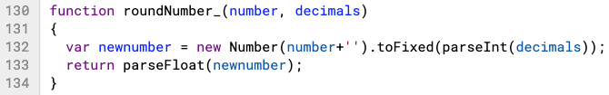

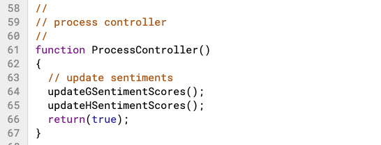

I see a similar parallel in Google Apps Script where the Google designers specifically implemented a way to help non-technical users avoid running functions that require arguments. By appending an underscore to the end of the function name, it is hidden from view in the run options and toolbar.
Runnable …
Not Runnable …

I’m now getting a “Pattern Error” in the substitution part, any ideas on how to fix it?

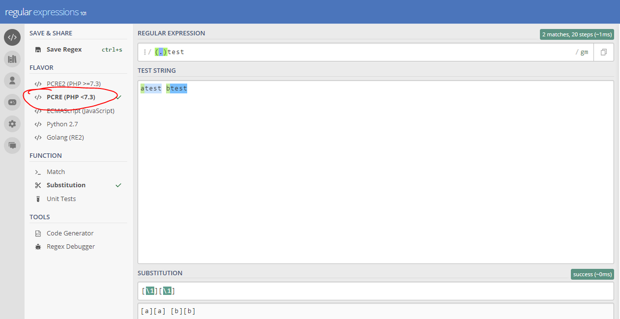

Try selecting a different flavor. I see that’s what changed since I recorded that video.
This works:
P.S. In PCRE2 it’s [$1] not [\1]
It worked! Thank you so much, this workflow has saved me and my clients so much work!
Thanks so much for this - it really will help me a lot but I just can’t get it to work (sorry, I have zero experience with coding so I am reaching out in the hope you can help)
As you can see from the screenshot below, the formula is failing to recognise that anything in the is a value/column
Screenshot 2021-08-18 at 11.15.10
Is there anyway you could help please?
