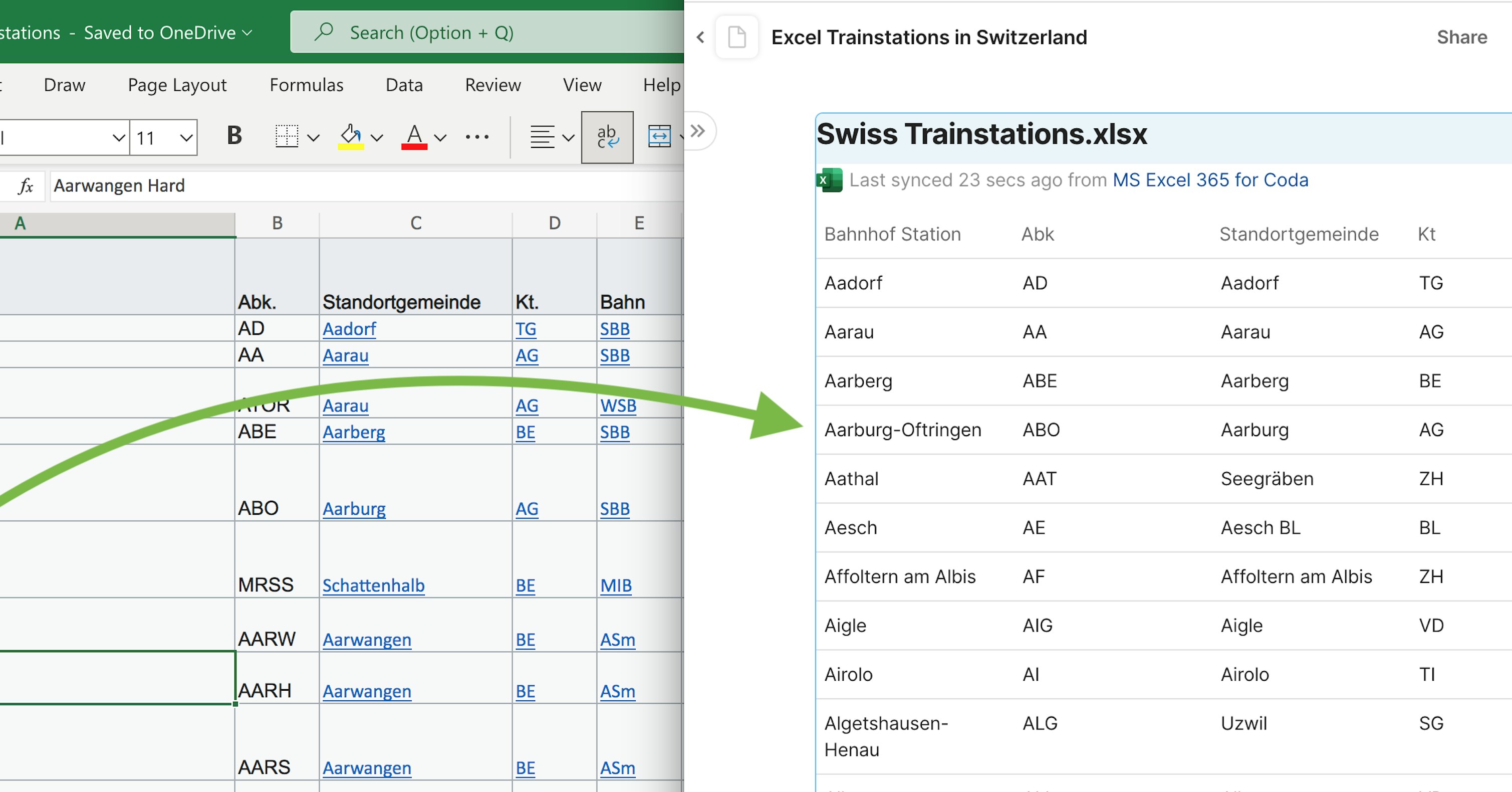

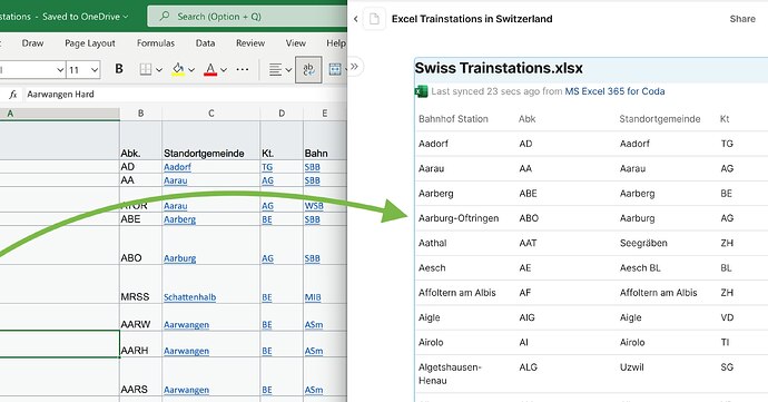

We’ve officially launched the Excel Magic Coda Pack!
Try it out and let me know if you have any issues!
@Bertrand_Bouteiller @Daniel_Dias @Eric_Koleda @Jean_Marc_Dieu
The game changer of Troy’s Excel pack is being able to Sync from Coda to Excel (and two-way) instead of only one-way from Excel to Coda.
