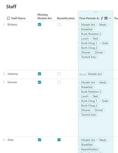

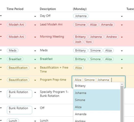

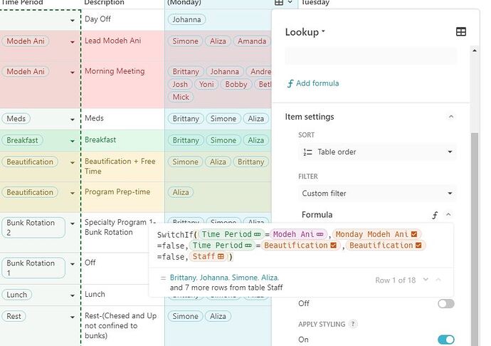

Hi all, I’m trying to use coda to make a scheduling table, where individual staff have different assignments during the same period. I want to include a catch to make sure I don’t assign the same staff twice during the same period. I’ve been trying to change the item settings on my lookup column (which looks up staff on a separate table) so that if they’ve already been assigned during that period, their name doesn’t show up.
However, it only seems to be working for the first argument. For the second argument, all staff still show up even though they have an assignment during that period. Any ideas? Picture for Reference.
![full schedule modeh ani selection](https://us1.discourse-cdn.com/flex016/uploads/coda1/original/3X/f/d/fd8f6da546dbad5d253fa951244b0446778d8006.jpeg)

Hi Brittany,
What you describe is definitely possible, but I don’t think your current schema (the structure of your tables) is the way to do it.
I’ll take a crack at coming up with a solution for you, but I want to make sure I understand what you’re looking for.
It seems in the doc you sent it already limits the people you can select to those that aren’t yet allocated.
Or do you mean that if they are doing Breakfast on Monday they can’t also do Breakfast on Tuesday?
If that’s what you meant, you can create a column called [All Days] that has the schedule from all of the days put into one, then your lookup filter can be:
[All Days].Contains(thisRow).Not()
I implemented it in the [Tuesday] column for you:
