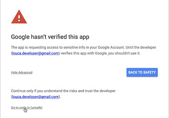

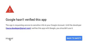

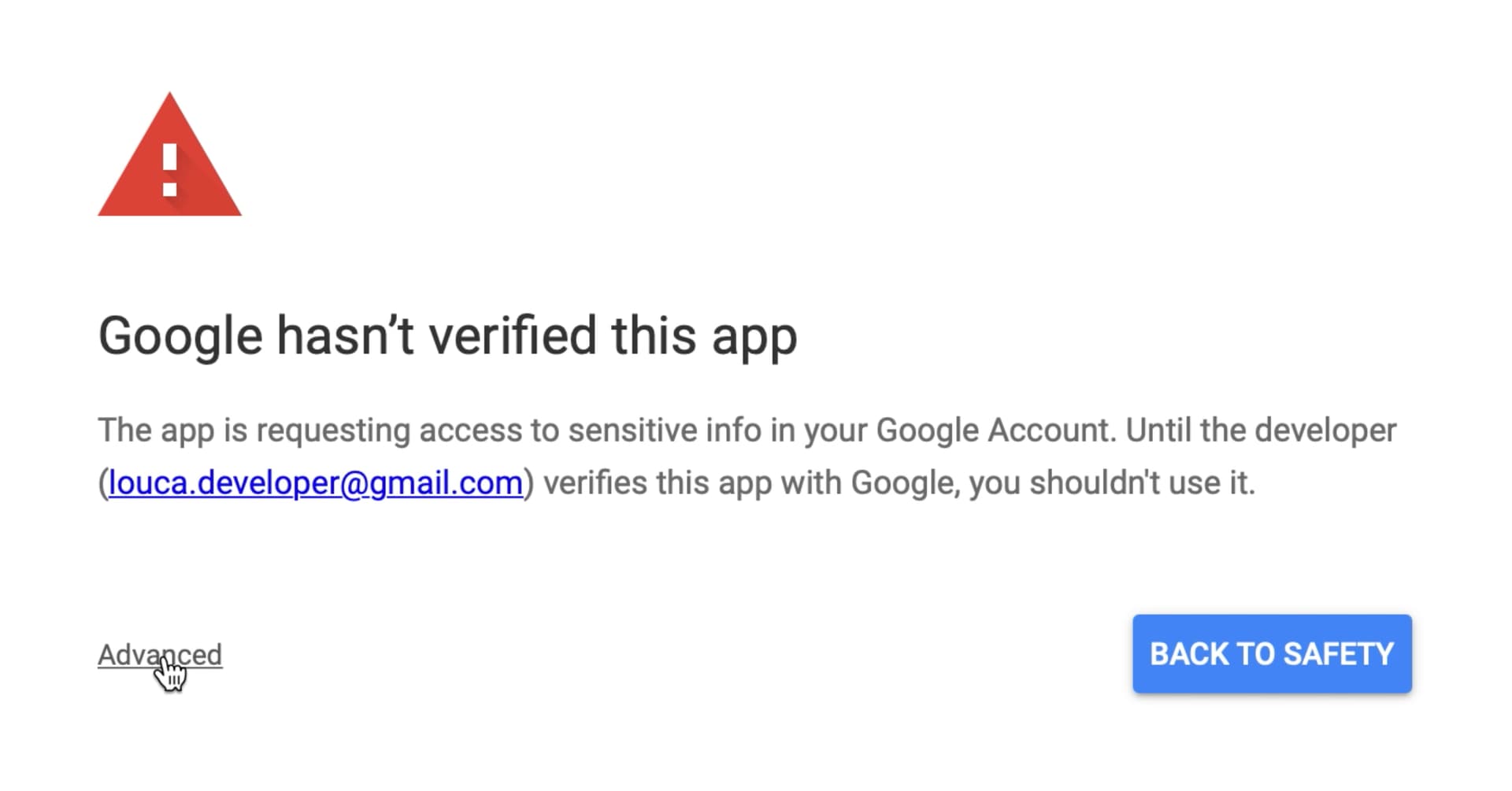

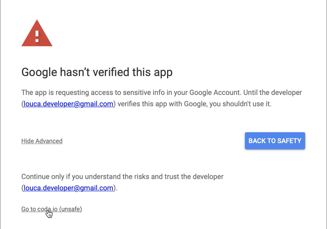

Since the pack uses Google APIs to access Google users’ data, it must undergo a verification process before being properly published. At the moment, it is published but unverified. This means that you can connect your Google account, but Google will display a scary “Unverified app” screen before displaying the usual OAuth consent screen. You can read more about it here: https://support.google.com/cloud/answer/7454865
There is no good way yet as a Pack developer to verify Coda Pack with Google, so the workaround is to click on the “Advanced” link in the “Unverified app” screen, and then on the “Go to coda.io (unsafe)” link. See images below.
