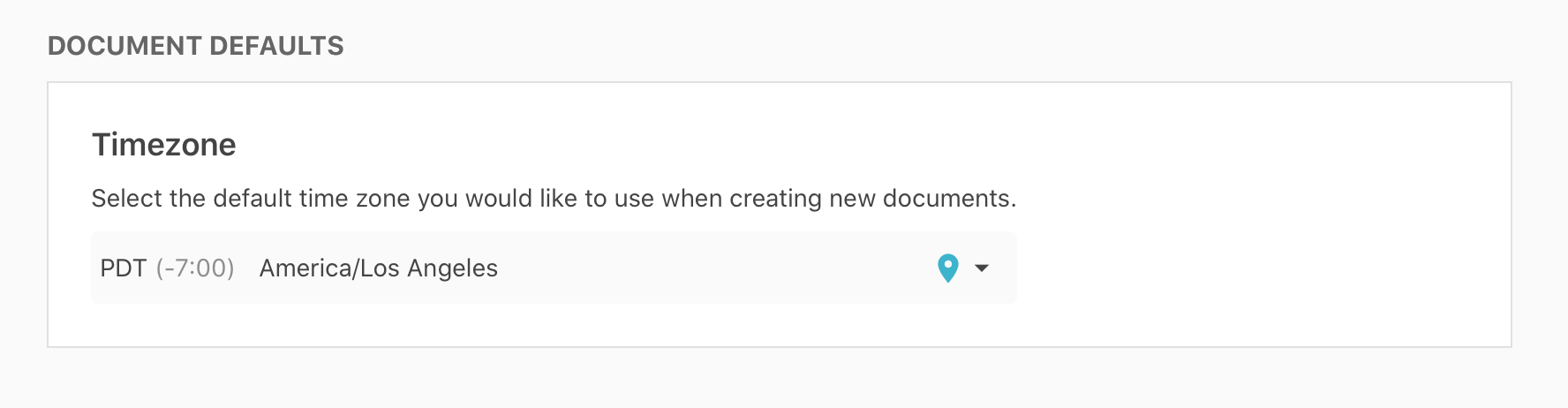

First, change your default Time Zone at coda.io/account so that new docs moving forward will honor it.

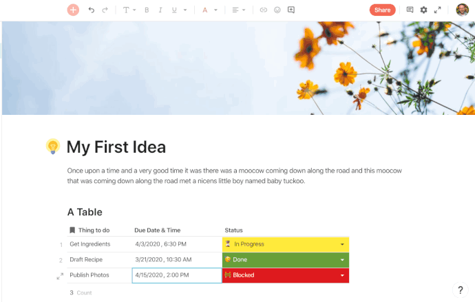

Then, for any existing docs, you can update your doc settings to your preferred Time Zone using the doc settings right-side panel.
