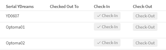

It would be nice to have a way to lock a cell for editing depending on certain conditions.
In the example Above I only want the Checked Out To Column (cell) to be editable when CheckedIn=True.
This will prevent someone changing the field when my equipment is Checked Out.

There is support for this:
In this example, the Check Out button is only clickable once the Checked In box is checked.
You can take this further and make the Check Out box reset the Check In box.

Hmm I don’t think that’s exactly what @Gavin_Goncalves means. It’s the “Checked out to” column that would be good to be disabled.
The buttons can be disabled so it would be a neat feature to extend this to all columns with a “Lock if…” section.
Hi @Michael_RnW, Exactly what you said.
I am already disabling the buttons. They are never active at the same time. and the Check-Out button is only active when I have text in the Checked Out To field and CheckedIn=True.
Would be nice to have a similar Disabled if for the Column the Same as the Buttons have
