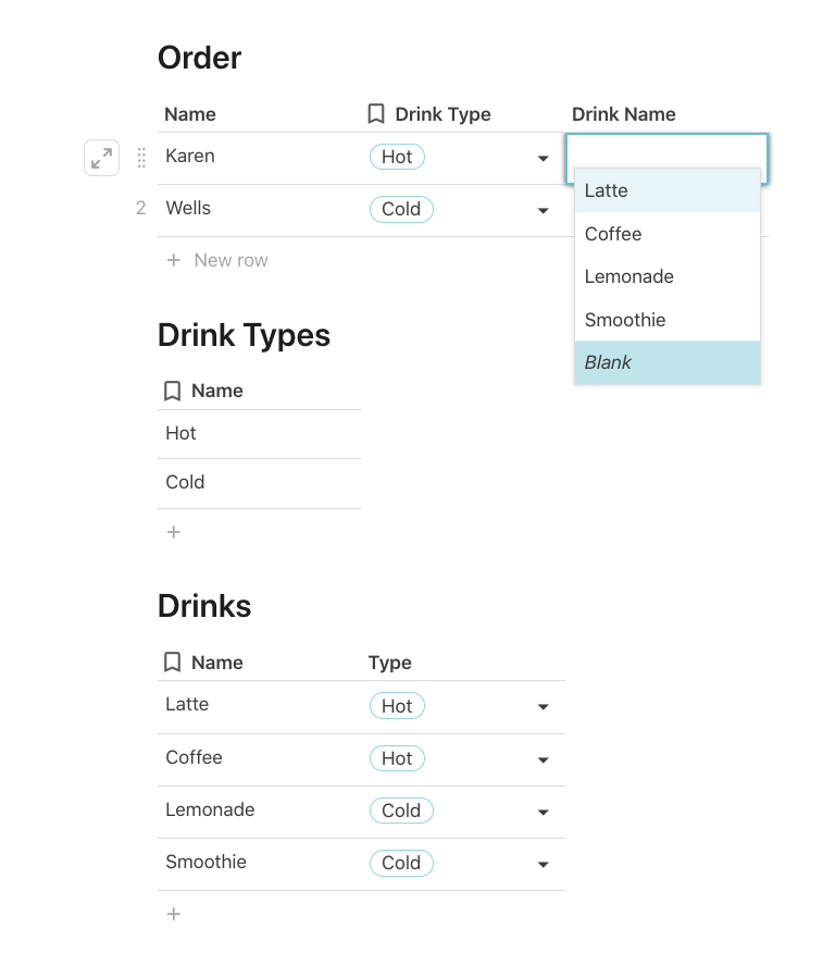

I’d like to filter [Order.Drink Name] so it only shows Hot or Cold drinks based on whether [Order.Drink Type] is set to Hot or Cold. Both of those columns are lookups to other tables.

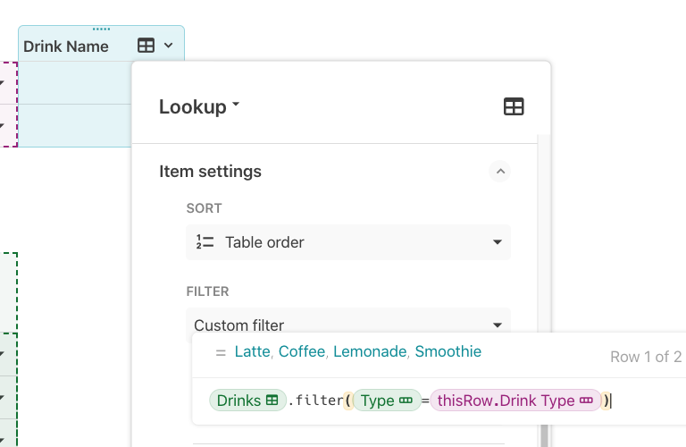

Here’s the custom formula filter on [Order.Drink Name]
But that always shows all drinks hot & cold.

In the filter, you just have to provide the filter condition as it is already contextual.
therefore:
Type=thisRow.Drink Type
(I changed it already on your doc)
I hope it helps.
Cheers!
Thanks! That was stumping me. Here’s a pic for reference in case others need the visual
