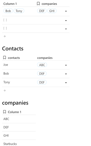

I am using the lookup formula to look up contact information of a given company, but when I multi-select two companies to look up it doesn’t work. Has anyone found a fix to this?
In the below example, I would want the contacts for ABC and DEF to show up

Yes! The formula I am using is: Lookup(Companies,Companies.[Company Name], thisRow.[Column 1])
My goal is to look up both ABC and DEF so that column2 = Joe, Bob, Tony

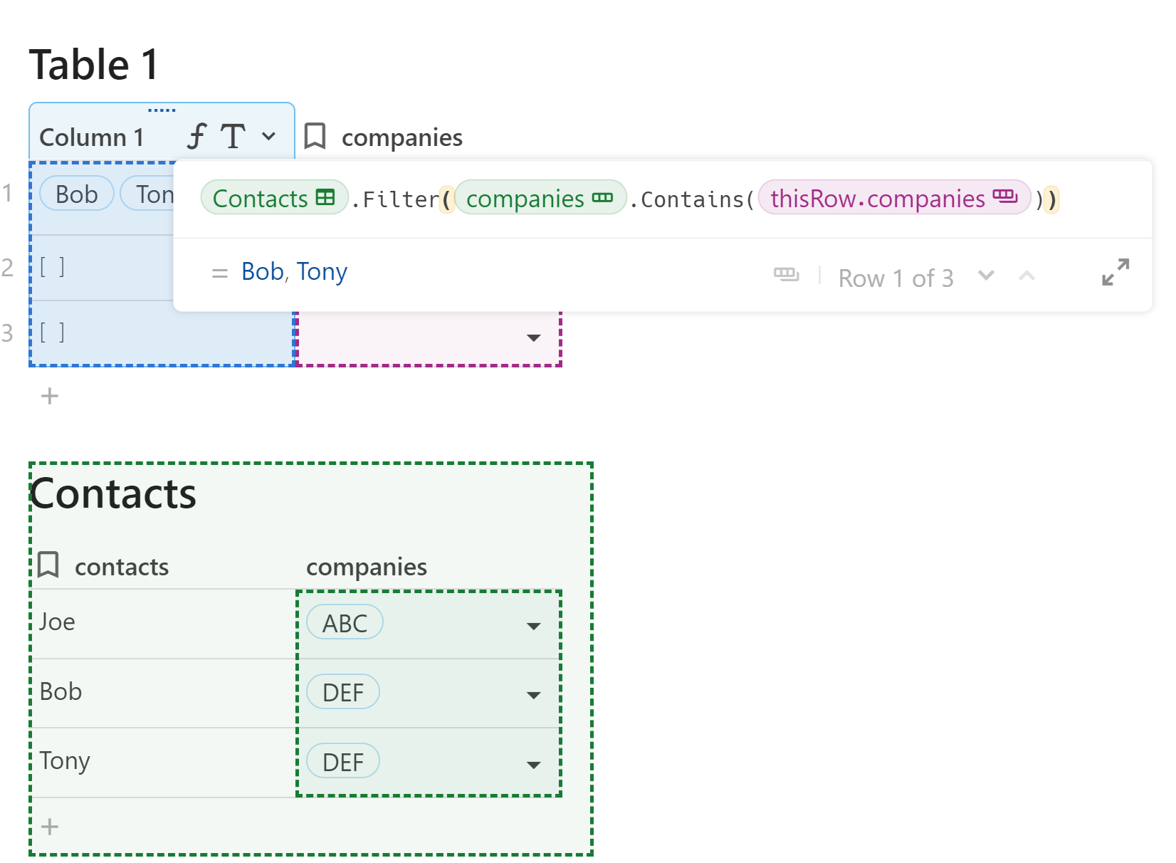

hi @Hannah_Krumholz ,
what about this one Contacts.Filter(companies.Contains(thisRow.companies))
I am not so into the lookup logic and replaced with a Filter()
Cheers, Christiaan
Hello @Hannah_Krumholz!
As @Christiaan_Huizer noted, you could change the lookup to a Filter() as it gives you more flexibility.
But you don’t really need a lookup nor a Filter formula in your case, as in the Column 1 you are pulling the Companies rows directly so you can get the Contacts directly from the Company Row as it follows:
[Column 1].Contacts.ListCombine()
