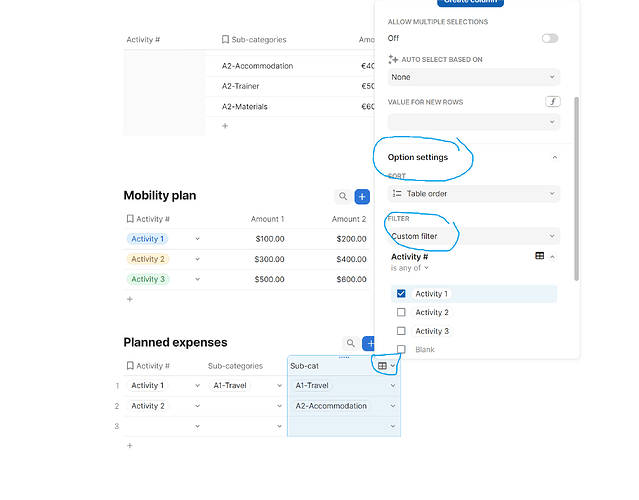

I am struggling to find a solution how to create a drop-down list where only certain elements are visible based on a filter. It is hard to explain so I created a dummy where you can see.
My goal is to have a drop-down list in the last table called “Planned expenses” but only with the expenses connected to Activity #1 not all. Somehow I am unable to create a working filter.
hi @Tamas_Mahner ,
it is maybe less evident than you expected, however it is possible. have a look at my screenshot. two steps are important:
  1. turn the column into a relation (former lookup)
  2. next, go to the options and look for custom filter
more back ground info om comparable questions you find in the blog below.
Cheers, Christiaan

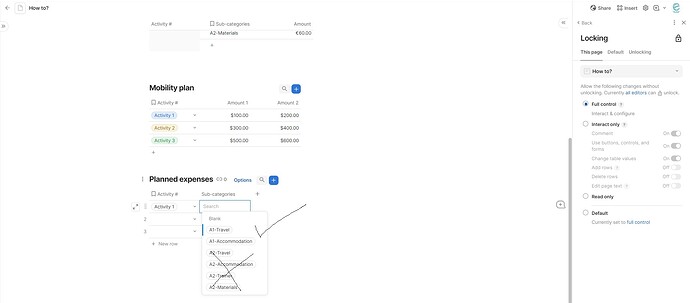

I think it was too late and I asked the question wrongly. What I would like to do is that when Activity # is Activity 1 then only the Expenses connected to Activity one appears in planned expenses (A1_Travel, etc.) When it is Activity 2 only Activity 2 expenses are in the dropdown (A2_Travel, etc.)
For some reason when I create filter or lookup it gives back nothing. :frowning:
