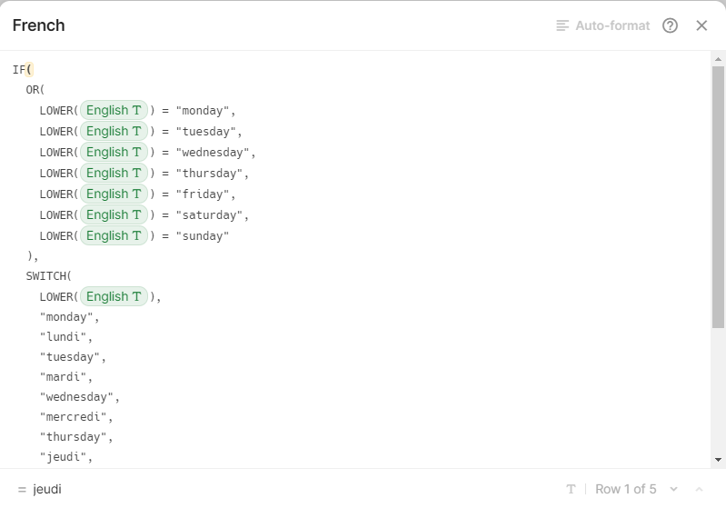

Hello @Nick_HE
Thanks for your help already :), if I understand correctly it looks a bit like what I did in the “French” column of the “Automatic translation” table?
Link with the formulas :
