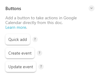

Google Calendar table works well and pretty easy to setup. Two minor things from me:
  1. When I am creating new sync, there is syncs daily desciption at the bottom. But in settings it can be set to manually.
  2. These buttons look like, well, buttons. I tried to press it! Maybe pressing it should insert into doc example button or, at least, show the action formula.

Thanks for the feedback Denis, we’re changing the UI for the button so they look less obviously like you can click them!
Also on 1. was your feedback that you wanted that option to change it to manual refresh in that first set of options? Our assumption is most people will want automatic refresh so we moved the refresh out to make it simpler.
No, I mean: it is confusing when you add new table then open Settings and see that this option is already set to Manually, but should be set to Daily.
Oh I see! That will be consistent soon :slight_smile:

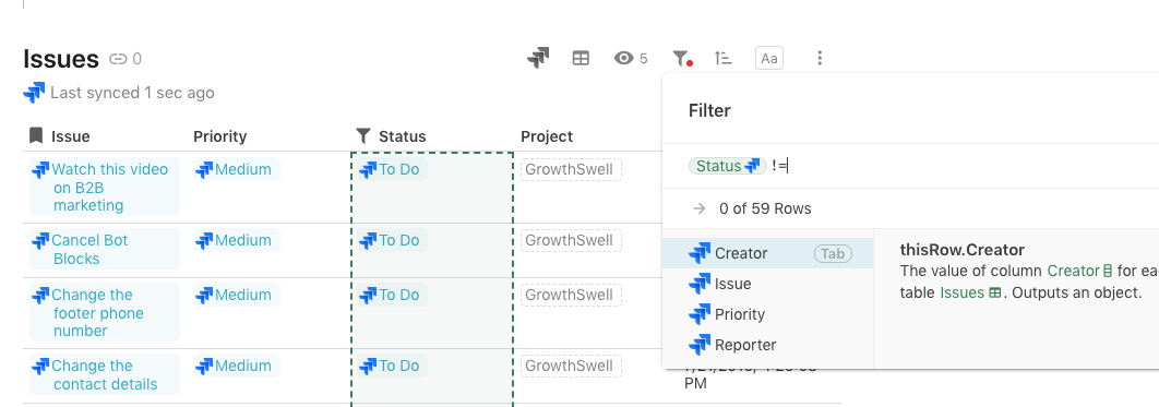

Jira issues table feedback- things I’d like to see.
I understand some of this might not be possible but if it were. It would be kick butt.
  • Jira doesn’t have roadmaps at issue level so this is something that would be a benefit, but we need Start and due dates for that.
  • It would also help to have the Sprint the issues are in as well as to know if the issues are in the backlog.
  • I’d personally like to see the issue types as well, so that I could create views for the specific issue types.
  • I can’t seem to filter on Status = !Done
Also I deleted a card, but it did not delete in Jira. I did notice that when I switched back to the row view I don’t have the ability to delete a row. So there is a little consistency there.
Hey Marni,
Thanks for the feedback this is really helpful
  • I think you can get the start/due dates by making a new column with =issue.duedate
  • Status is actually a Coda object full of rich data, we just only show the name by default. That filter should work as Status.Name!=“Done” or you can make Status.Name as a column.
  • Being able to delete a card is a bug (we don’t actually let you add or delete Jira issues from Coda yet)
I’ll look into some of the rest of your feedback with the team and see how we can improve the default table to make this easier and add better support.
