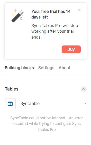

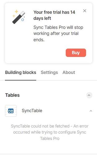

I have tried to install your pack on a trial, but i cant load any tables when i go into the pack. Pls see the attached screenshot below. What should i do?
Oh hey @yscias, terribly sorry for overlooking your question.
That’s a strange error and a non-descriptive one unfortunately. If this is still relevant for you, please DM me or write at paul@codatricks.com and we’ll book a call where I’ll try to troubleshoot it
