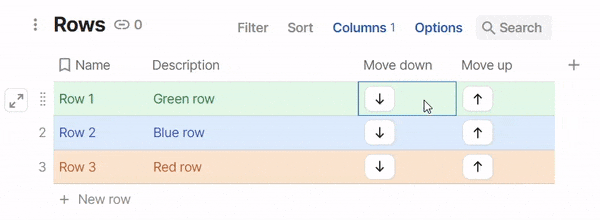

Anything you can do manually in Coda can be turned into an action!
How about an action to truly reorder rows, without compromising on manual dragging?

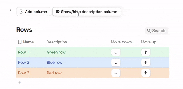

Or hiding and showing columns by a click of a button?
ezgif.com-optimize (1)
Or actually adding columns through an action, in those very few cases when you actually need it?

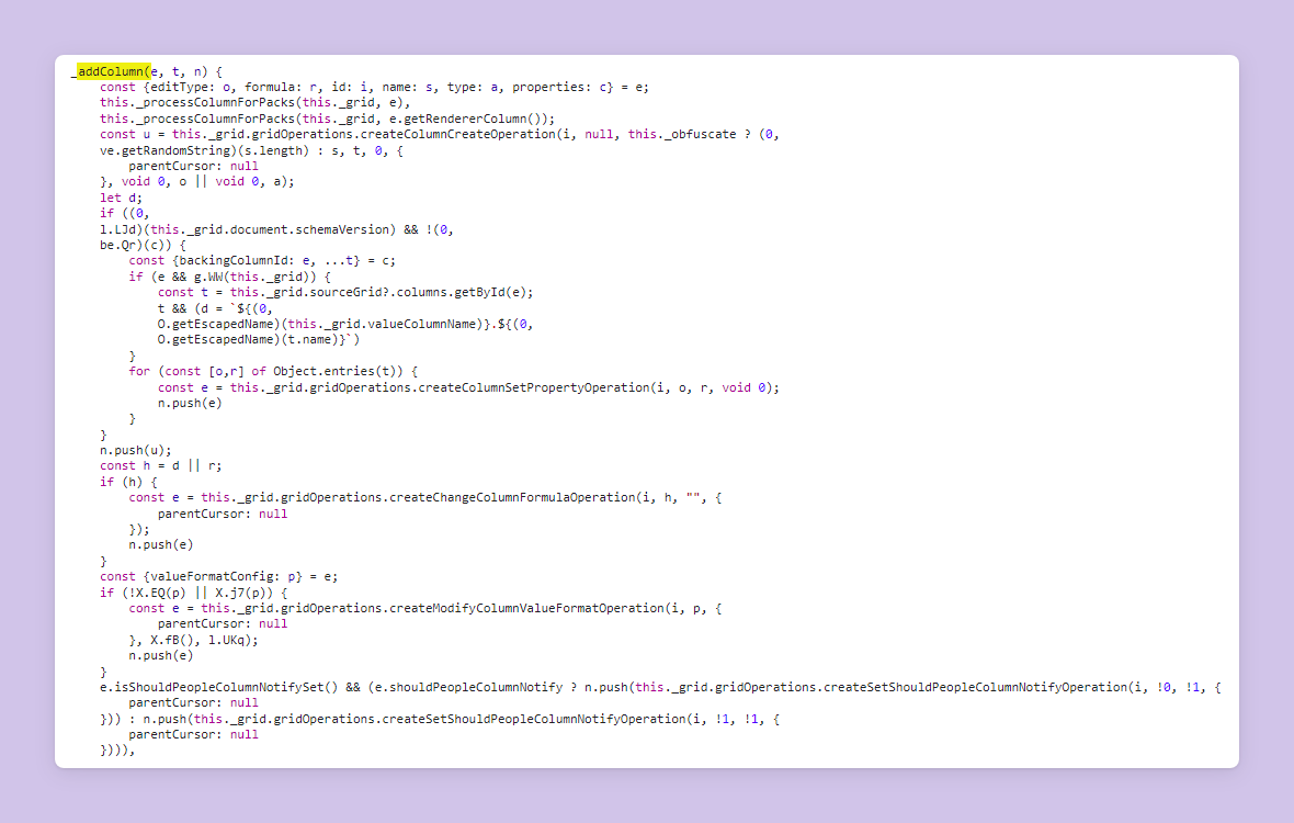

I tapped into the frontend code of Coda — the ~400k lines of code that run the whole Coda editor.
I started exploring the document model — different modules and APIs within Coda’s frontend JS code responsible for pages, tables, formulas etc. The code is minified and obfuscated, and looks like an illegible mess. But I was so deprived of some Coda hacking lately, I eagerly took it up for a challenge :slight_smile:

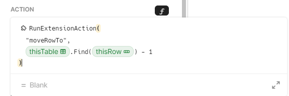

The way the extension works with CFL is rather ingenious too.
At first I was thinking of a Pack-based setup (requiring a backend and a realtime messaging mechanism to deliver updates back to the browser) and I implemented that. But then I realized it had to be more straightforward. So I found a way to hook up to the CFL directly! The way this works is:
  • Anywhere in your action formula you make a call to a special ‘bogus’ pack like this:
    It doesn’t have to be a single call on the formula — in fact it can be a 50-line long formula with many RunExtensionAction calls like this, and it will still run fine!
  • The extension intercepts calls to this particular pack and redirects them to the extension code, executing them immediately on the client side!
In the case the extension is not installed, the pack will simply show an error saying so. In fact that’s all that the pack does: it throws an error :slight_smile:
That’s because the code shall never reach it.
