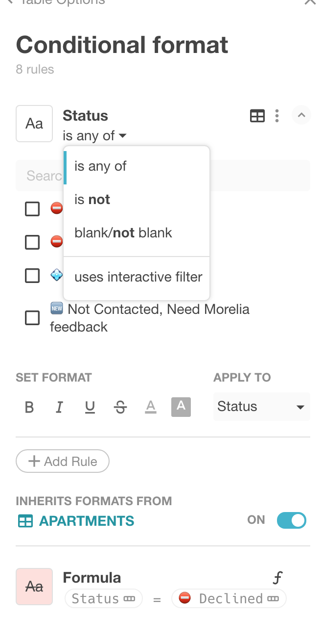

I’m trying to do add a “conditional formatting” rule to a table. The table was created in this template (https://coda.io/@rod/apartment-hunter), which I’ve copied and completely revised. (Thanks @Rod!).

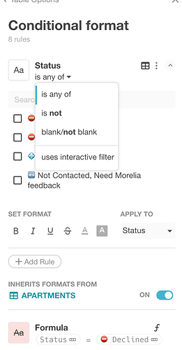

First, there are the formula options that appear:
Since, the " = " doesn’t appear, which is what is used with all the rules that work, I choose one and then click into the formula and add the " = " there.
Then, after changing the formula to reflect what works below, I can’t complete the final step and get the rule to be applied. Instead, the new rule stays “above the fold” and doesn’t get accepted.
Any thoughts on what I’m missing?
Your screenshots show a toggle control called “Inherits Formats From: Apartments”. This indicates that you’re working on a View of a source table, rather than the source table itself.
When it’s toggled on, you can only change cf rules on the source table.
When it’s toggled off, you can create cf rules on the View, independent of the source table.
