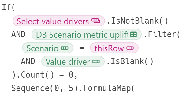

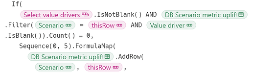

@Paul_Danyliuk do you have any advice on how to best space/format a long formula when chaining / not wrapping? When I have a long formula it makes sense to me to write:
if(
1=1,
true,
false
And I’d “indent 1=1, true, false” two spaces (this formatter won’t let me do that in this reply).
What are you best practices for formatting a long chained formula for human readability?

Let me reply in a few minutes. Short answer: use your best judgement when to break down formulas into multiple lines. I’m coming from Java background, so I tend to use Java code style -like. And people coming from C would code their calculations in C instead of using Coda at all :upside_down_face:

@Johg_Ananda Okay, here’s a more expanded reply. I’d illustrate it with a formula I wrote yesterday:
RunActions(
  [DB Scenario metric uplifts].Filter(
    Scenario = thisRow
    AND [Value driver].IsNotBlank()
    AND thisRow.[Select value drivers].Contains([Value driver]).Not()
  ).DeleteRows(),
  If(
    thisRow.[Select value drivers].IsNotBlank() AND [DB Scenario metric uplifts].Filter(Scenario = thisRow AND [Value driver].IsBlank()).Count() = 0,
    Sequence(0, 5).FormulaMap(
      [DB Scenario metric uplifts].AddRow(
        Scenario, thisRow,
        Year, CurrentValue,
        Ramping, [Template ramping].Nth(CurrentValue + 1)
    _Noop()
  If(
    thisRow.[Select value drivers].IsBlank(),
    _Noop(),
    thisRow.[Select value drivers].FormulaMap(
      RunActions(
        thisRow.ModifyRows(thisRow.[_Current value driver], CurrentValue),
        thisRow.[_Current value driver].[Metrics Impacted].FormulaMap(
          RunActions(
            thisRow.ModifyRows(
              thisRow.[_Current metric impact], CurrentValue
            thisRow.[_Add current metric impact]
As I said above, I use best judgement when deciding whether to break down into separate lines or not. The goal is formula readability in the constraints of a pretty narrow window. If breaking down into separate lines makes reading the formula harder and not easier, it would make sense to not do that, right?

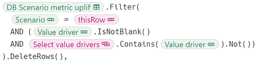

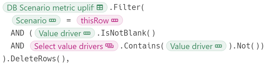

Example of that:
In the DeleteRows formula, I’m breaking down the conditional in Filter into separate lines:
This is what I’m usually doing BTW with long boolean expressions with lots of ANDs.
However, further down I’m not breaking a similar long filter expression into separate lines:
This is easier for me to read because I know that to jump to the if expr=true clause, I don’t need to scan the formula line by line, but can simply jump the block of text that overflows, right to the next indented line. Whereas if I broke down the expression like this:
it would require me to scan each line, looking for a comma.
My rules of thumb:
  • RunActions() — always break down and indent, each action starting on a new line. If actions are too long, consider adding empty lines between actions.
  • FormulaMap() — always break down and indent.
  • Filter() — keep inline if the condition is simple (only one operation e.g. X = Y or X.Contains(Y).Not()) or breaking down would only make overall readability worse (e.g. when surrounded by lots of other code), otherwise break down and indent.
  • If() — keep inline if the condition is simple and the true/false values are simple as well, otherwise break down and indent.
  • Switch() — always break down and indent. Write the expression on a separate line, then case and value pairs each on the same line if the case is just a value. Otherwise consider using SwitchIf().
  • SwitchIf() — always break down and indent. Write expressions and calculations on separate lines. Consider adding empty lines between expression/calculation pairs if either part gets broken down into multiple lines itself:

  • AddRow(), ModifyRows() — only consider keeping inline if you’re setting one column->value pair, otherwise break down into separate lines, with column and its value being on the same line:
Also if one of the paths in an If() is long (i.e., takes more lines than a formula editor can display), and the condition is easy to swap (e.g. just replacing .IsBlank() with .IsNotBlank(), consider writing a shorter path, e.g. _Noop(), first, so that you can see it while still seeing the condition:
