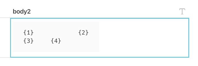

Another approach is to set the template to use the code formatting attribute and then experiment with tab characters to separate names from values.
In so doing, you can achieve a similar formatted outcome without all the tab computations in the formula itself. This approach is equally brittle in that the length of the name/value pairs on a given line could create issues.
But, to make this work really well (and reliably) Markdown (and/or CSS) is needed. I would love to see this supported in Format() templates.

@Bill_French OK thank you for the great solutions. So I think this turns on how the ‘tab’ works. It seems that it will create a specified amount of space (the tab length) but allows itself to be ‘devoured’ by characters to the left up until the point at which they would ‘touch’ the tab itself and then its pushed another tab length forward? This is what induces the brittleness?
And if I’ve got it right, your second solution is exactly the same as the first, but just ‘hard codes’ the tabs in instead of creating the formulaically and would be superior due to its simplicity?
I believe so, yes. If you experiment with different name lengths you can break it. Perhaps the formula could be improved to avoid this, but it’s an issue worthy of disclosure.
Yes - well-stated. Certainly simpler to implement the code-formatting approach and I suspect this demonstrates a capability that could be handy at times. However, I’m reluctant to say that any of this is “superior”; it’s just a way to format two columns inside one cell with caveats.
If the name values were more predictable in terms of length, one might feel like this is a solid approach. And I suspect there are cases where the labels next to the graph bars are more predictable, thus making this tab approach quite useful. One more arrow in the quiver, right?
OK got it. THANK YOU!
Yes, for a dashboard where the field labels are known this is a great solution. If you are using it for something like user names where string length isn’t bound then yes you could get bugs. Got it. Great temp solution until the Codans update the format potential.
